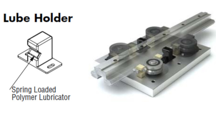

Oil Filled Polymer Lubricator
Some PBC Linear products offer a high quality polymer lubricator. PBC uses an advanced, oil filled porous polymer which has been tested to show better performance and longer life than similar wiper/lubricators made of oil or grease filled felt. In some applications, this special lubricator will last the life of the application without additional re-lubrication.
This lubricant within the polymer is NSF registered for both H1 & H2 applications (direct & indirect contact with food). It can also be used for wash down & industrial applications. The lubrication within the polymer contains corrosion inhibitors, anti-oxidants & extreme pressure (E.P.) additives. Table 1, below, shows some specific properties for the lubricant.
