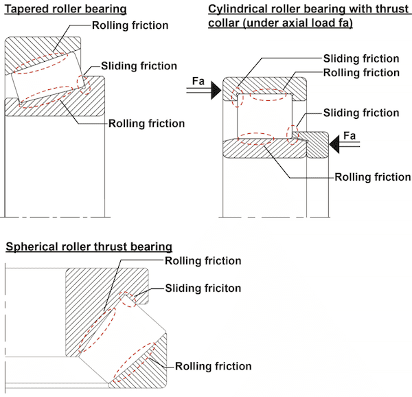

                             Figure 1: Friction at rolling contact and guide flangesclose

The high measured operating temperature was the direct result of the metallic contact and resulting friction especially between the side faces of the rolling elements and the guide lips of the shaft locating washers (see spherical roller thrust bearing in Figure 1). This resulted in irreversible damage to the bearings’ functional areas within just a short time, in effect preventing reliable long-term operation. The bearings had to be replaced at considerable expense on site.
By changing to a suitably viscous oil selected for the application parameters and the use with spherical roller thrust bearings, a reliable separation of the contact surfaces and a low operating temperature were achieved. The plant has now been in fault-free operation since 2009.
