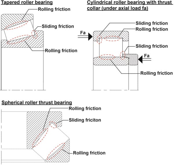

                                      Friction at rolling contact and guide flanges
Lubrication is a critical element of the entire bearing system and must be carefully considered. About 40 percent of all premature bearing failures are caused by lubrication problems. The reasons for this are varied and start with mistakes occurring during the installation of the bearings as well as incorrect maintenance, such as failure to relubricate on time. Some problem can be traced back as far as the design stage of an application, with too little attention being paid to the bearing arrangement and lubrication system, because the type of bearing used generally affects the lubrication requirements. Further criteria for selecting the proper lubricant are bearing load, the operating temperature, the ambient temperature of the bearings, the bearing speed range, and possible contamination of the bearings. In addition to technical factors, the costs of both lubricant and complete lubrication system must be considered.

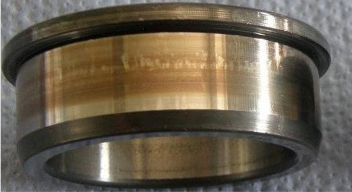

                 Inner ring of cylindrical roller bearing after operation with excessively mobile oil
To be on the safe side, a practical test was performed, in which two identical gearboxes were filled with the lubricating oils to be compared and run for a period of 500 hours. In the subsequent survey, discolorations and initial signs of wear were clearly visible on the functional surfaces of the bearing run with the thinner oil (Figure 2). The bearings operated with the thicker oil did not show any signs of wear (Figure 3).
The customer’s fear that the thicker oil would result in higher power dissipation proved unfounded. On the contrary: the gearbox with the more viscous oil exhibited lower losses and therefore also a reduced operating temperature. This can be attributed to the better separation of the metallic surfaces in operation, which more than compensates the slightly higher fluid friction.

The high measured operating temperature was the direct result of the metallic contact and resulting friction especially between the side faces of the rolling elements and the guide lips of the shaft locating washers (see spherical roller thrust bearing in Figure 1). This resulted in irreversible damage to the bearings’ functional areas within just a short time, in effect preventing reliable long-term operation. The bearings had to be replaced at considerable expense on site.
