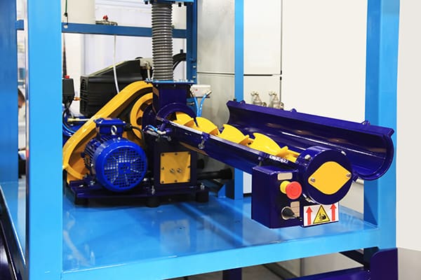

We received a call from a recycling plant who were struggling with excessive downtime on their spiral auger. The time that it was taking to dismantle surrounding equipment to allow inspection, maintenance and refitting of the bearings was causing a huge drop in production, leading to lost revenue.
After a thorough investigation of the issue, the products suggested were SKF Cooper split roller bearings with pillow block pedestal housing units. With a split to the shaft design, these bearings allow inspection, maintenance and refitting at the shaft, without needing to dismantle any surrounding equipment.
This split-to-the-shaft design can reduce downtime by up to 88%, saving companies both time and money. It also improves worker safety, as heavy machinery doesn’t need to be moved or taken apart.
We also suggested a double lip nitrile rubber seal, which is well equipped to deal with the high levels of contamination commonly found in recycling plants. This will protect the bearing from the external environment, as well as sealing in the grease or lubricant, enabling the bearing to operate in optimum conditions.
