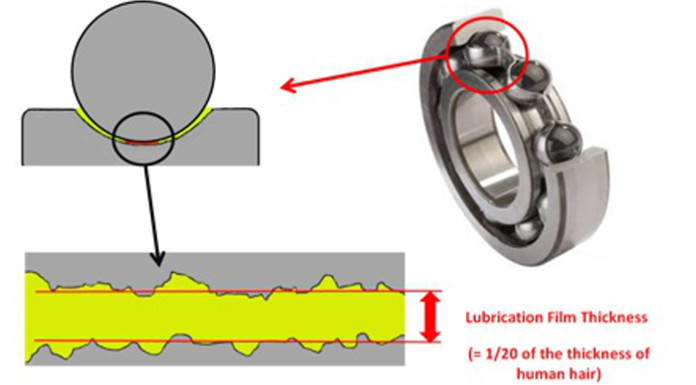

It is all about Lube Film!
Firstly let us talk a little about what causes wear and equipment breakdowns.
SKF has stated that, “bearings can have an infinite life when particles larger than the lubricant film are removed.” Meaning the removal of abrasive particles prevents bearing wear.
In a bearing with a good average lubrication film thickness, the metal surfaces are separated and the average thickness of this separation or film is very small, in fact it is about one twentieth of the thickness of a strand of human hair. See figure 1
An analogy is that when a 50 micron of hard contaminate, goes through the bearing, it is like driving your car over a 1 meter diameter boulder. When there are hard contaminants in the oil and they are greater in size than average lube film, then 3 body abrasive wear starts to happen. This then leads to surface indentation and scratching, which is a process that can lead to bearing or component failure.
A good average lubrication film thickness in a machine or component is the result of a lubricant operating with an effective viscosity. Assuming the right lubricant viscosity has been selected in the first case, then if the oil is kept clean, meaning that there is a very low level of abrasive particles in it and there is no degrading of the chemical composition of the oil, then the lubrication will do it’s job. – provide an average lubrication film thickness that will separate the metal components and eliminate or reduce wear.
