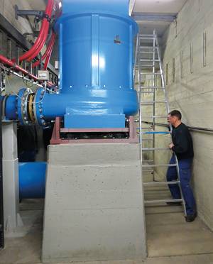

Figure 1: The vertical motor is flange-mounted directly above the centrifugal pump. Alignment corrections are made by shifting the electrical motor on the flange

The machines are overhauled every 5 years and are then remounted and realigned. Good alignment ensures smooth operation of the pumps throughout their service life. On account of the long service interval, it is important to optimize all of the parameters to keep the machines running properly until the next scheduled overhaul.

Incorrect alignment leads to a markedly higher level of vibration, which can cause premature damage to the bearings and floating ring seals.

Figure 4: Vertical pump after remounting but before alignment
Immediately after the overhaul and reinstallation of the motor, technicians check the alignment and, if necessary, correct it before the machinery goes back into operation.The vertical pump is measured using OPTALIGN smart RS
First, the procedure requires the machine dimensions and flange sizes such as the flange diameter, bolt circle diameter and number of bolts.The readings are taken at predefined locations.Ideally, up to 8 measurements can be taken at an interval of 45°. These measurements are then used to compute the results.

Figure 6: Adjusting bolts on all four sides of the motor are designed for adjusting the
After the motor has been aligned, final verification measurements are taken and stored electronically for quality assurance.
pruftechnik-7
Figure 7: After correction and final measurement, the motor exhibits perfect alignment of the shafts.
