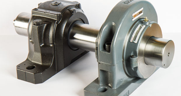

Kings Lynn, UK, February 2016. Cooper Bearings, an SKF Group company, introduces the SNQ pedestal, a new range of plummer blocks for split roller bearings. The angled SNQ pedestal simplifies the fitting of bearing units as the angled joint allows the pedestal to be slid under the shaft without the need for tools.

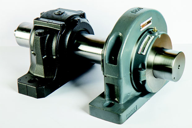

Cut-off view of a Cooper angled plummer block and bearing.
Pedestals, also called pillow or plummer blocks, are the most common mountings for bearings. Launched by Cooper and available for many years as a “bespoke” solution, the angled pedestal is now available across the standard range of SN and SD equivalent pedestal housings. With the SNQ angled pedestal, bearing units are now even easier to fit as the angled joint allows the pedestal to be slid under the shaft without the need to raise this with a hoist or jack, reducing expensive downtime.
Detailed design and the number of fixing bolts vary with the bearing series and size. This includes two bolt, four bolt, and large-bore options. Besides the SNQ range, Cooper offers pedestal ranges that allow direct replacement of SN, SD, and SAF pillow block units. “The design builds on the Cooper concept of quick, easy and safe assembly and eliminates any impediment to conversion,” explains David Burns, Cooper’s European Sales and Marketing Manager. “The combination of same base to centre heights, distance between bolt holes, and angled pedestal means changing from a problematic non-split spherical roller bearing and plummer block assembly is simplicity itself.”
Cooper SN compatible pedestal in conjunction with an SKF plummer block.
