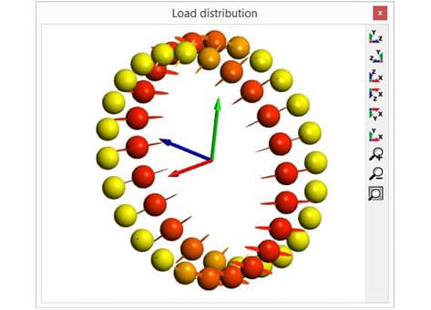

Double-row-axial-angular-contact-bearing-with-moment-load-cnt

  • Additional bearings types like axial spherical roller bearings, barrel roller bearings and double row axial angular contact bearing are now also supported. In total, 22 bearing types are available now.

  • New graphic for load distribution 3D, including contact ellipse or line load for rolling bearings.
