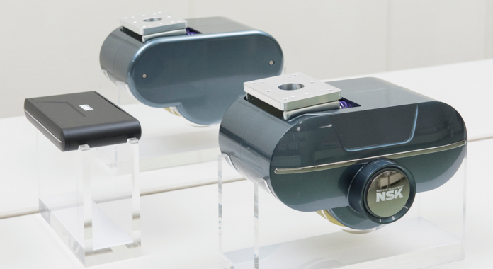

                                         A pair of NSK direct-drive wheel units with the dedicated drive
The quiet nature of NSK’s wheel unit can be attributed to its gearless structure (direct-drive motor), which leverages the technology behind the company’s Megatorque Motor to eliminate the operating noise generated by typical gearboxes. Using the Megatorque Motor as a wheel was a new concept, and NSK had to invent ways of employing the system’s parts to create the optimal specification at a reasonable cost.

In use, a newly developed dedicated drive controls two wheel units simultaneously via simple signals. The drive is equipped with sensors measuring wheel rotation, acceleration, tilt and other useful parameters. Signals from the sensors can be output for use by an on-board PC in autonomous robot applications.
