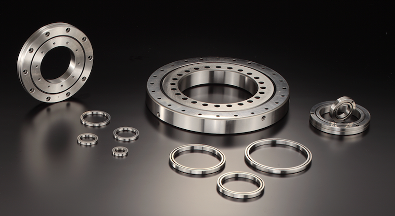

• Crossed roller bearings (CRBs). Designed to handle complex kinematic motion from all directions simultaneously, CRBs offer micron-level displacement with a compact footprint for wafer handling devices, including those that have long-reaching robotic arms with several pivoting joints. CRBs are available in highrigidity configurations, can be made from stainless steel, and can also be adapted for use in cleanrooms and modified to operate in vacuum environments. IKO’s CRBFV… series is noteworthy, partly due to its design with mounting holes about the inner and outer rings that allow for simplified installation while facilitating a lowcost, yet highly precise joint.

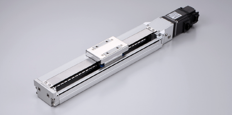

  • Mechatronics. Positioning tables and stages are another effective means of guiding or positioning loads with micron precision in automated equipment used for wafer handling, inspection or picking and placing. Many compact units are available, such as IKO’s NT Series linear motor-driven table with a moving magnet design that keeps the height low and eliminates moving cables and cable carriers that can otherwise produce particles and increase thrust force requirements. Another option from IKO — the TC Series — satisfies the ISO Class 3 (U.S. Fed. Std. 209E Class 1) standard for cleanrooms. It combines lightweight and a compact size with durable, corrosion-resistant aluminum and stainless steel construction, stainless steel coverings to prevent dust dispersal and a C-Lube built-in lubrication system. The TC series also features an internal magnet strip and threaded suction ports at either end of the actuator to contain and remove particles generated inside the enclosed actuator during operation.

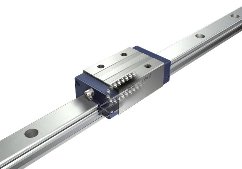

Your bearing specialist can recommend a suitable bearing specification with good rigidity to accommodate greater loads with low deflections or dissipate vibrations. One such product is IKO’s MX roller-type linear rolling motion guide in stainless steel, which features cylindrical steel rollers that make line contact with the raceway for exceptional rigidity and load capacity. IKO linear guides are available with several preload specifications and slide unit lengths to manage rigidity. Additionally, there are several options for wide-type track rails for increased moment rigidity. For CRBs, full-complement-type bearings offer high rigidity and load handling capabilities within lower speed applications while separator-type bearings offer the same type of performance across a wider range of use cases.
Ball-type linear rolling motion guide in stainless steel features large steel balls that make greater line contact with the raceway for exceptional rigidity
