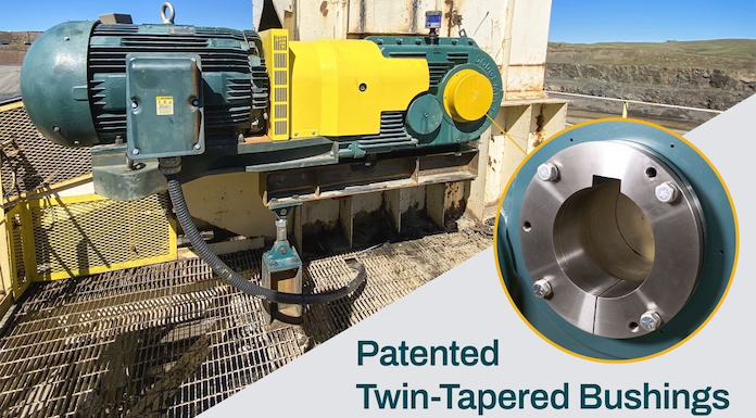

Designed as a direct-drive system built to outperform conventional shaft-mounted reducers, the MTA delivers both durability and ease of use. Its hallmark feature, the patented twin-tapered bushing system, allows for quick installation and confident removal, even in demanding environments. This translates directly into reduced downtime, lower maintenance burdens, and overall improvements in total cost of ownership.

  • Twin-tapered bushing technology ensures secure mounting, easy disassembly, and consistent torque transmission.

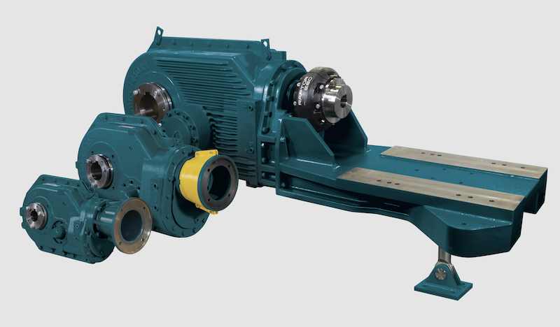

Foot-Mounted Motor Configurations with the Atlas Adapter
For larger drive packages, the MTA platform includes assemblies featuring the patent-pending Atlas Adapter, enabling seamless integration with heavy-duty foot-mount motors.
  • Available for reducer sizes 7–12
  • Supports drive packages up to 200 hp (150 kW)
  • Compatible with motor frame sizes 364T–447T
  • Equipped with a heavy-duty Raptor coupling for enhanced performance and reliability
  • Includes fan options that significantly boost thermal capacity, extending lubricant and product life
  • Delivered with tie-rod and torque-arm assemblies for a complete installation package
