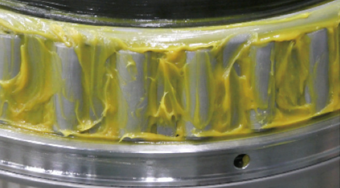

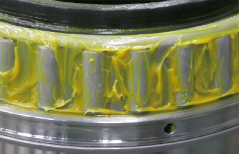

By optimising the grease composition it is possible to form and maintain a thick oil film between the bearing raceway surface and the rollers to avoid metal-to-metal contact. Moreover, the use of a special additive prevents water from contacting the raceway surface, inhibiting subsequent corrosion. NSK tests in a water-infiltrated environment confirmed that the new grease has a service life more than twice that of conventional lubricating grease, helping to avert premature damage.
