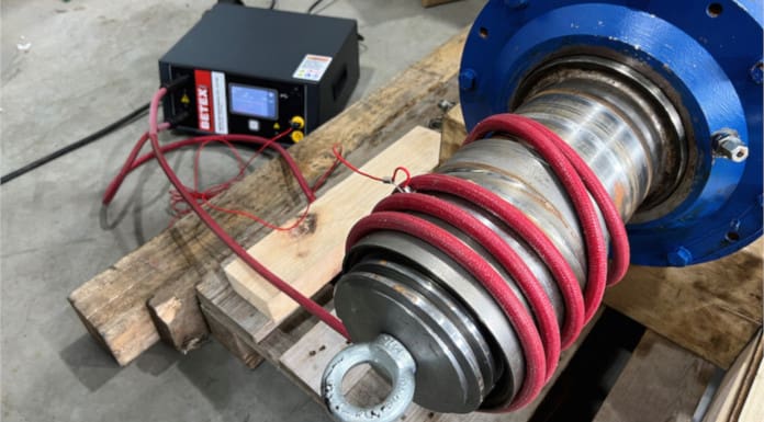

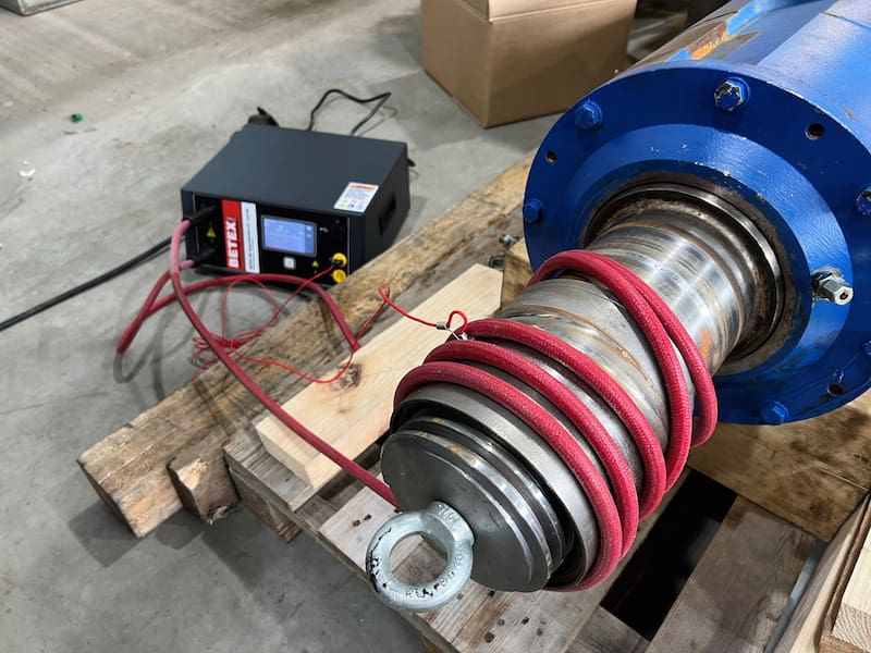

Example of heating: Dismounting a bushing from a pump used in the dredging industry. After 3.26 minutes the bushing had reached a temperature of 143.5°C and could be pushed off the shaft.

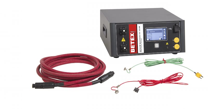

Induction heating is a highly efficient and eco-friendly method for industrial heating applications. Examples of applications are bearings, sleeves, gears, inner rings etc. The generator is combined with a flexible inductor which can be wrapped in or around a workpiece. It heats parts very fast or under precise control, depending on the application: dismounting, mounting, or preheating. The flexible inductors are available in optional lengths of 5 m, 7.5 m and 10 m, for a maximum temperature of 180°C. The heater is easy to use – just plug into the 230 V mains – with four different heating modes. Two magnetic temperature sensors make it possible to measure the internal and external temperature of a workpiece. When this Delta-T function is enabled, the maximum preset temperature difference between two points can never be exceeded. Smart electronics ensure optimal operation frequency. The heating process is displayed in a 4.3-inch touchscreen. A log function is provided for saving data or exporting it via the USB port.
There are many other reasons to consider induction heating in comparison with conventional methods. Heating is controlled, fast and energy efficient. The quality of work is better, it enhances machine up-time. Since there is no open fire, there is no polluting smoke or noise. Personal safety is also a point to take into serious consideration.
The MF Quick-Heater kit consists of one generator MF 3.0 – 3.5 kW, two magnetic temperature sensors, one pair of heat resistant gloves, flexible inductors in optional lengths of 5 m, 7.5 m and 10 m.
