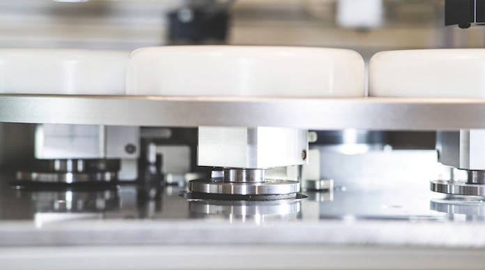

Eight-station index table side view showing Nexen servo clutch engagement at a spin station: After the spinning operation is complete, a new station will index over the clutch so it can be spun in its operation.

Cut away section of the eight-station index table, showing the servo clutch mechanisms located at the specific spin station locations. The actual clutch mechanism is blown up to show further detail. As the spin station is reached, the clutch mechanism is triggered to engage with the station, and the servo drives the workpiece as the process requires. The clutch then releases, and the index table can rotate to continue the next process.

                                                                       Detail of clutch mechanism
In the actual machine example, an eight-station rotary table was required for processing a workpiece. Of those eight stations, three required spinning as part of the process. Each station required a different spinning profile, the most aggressive being an acceleration from 0 to 3000 rpm in 0.25 seconds. After the initial acceleration the workpiece would decelerate to 0 in 0.5 seconds. At that point it was critical that the workpieces were stopped in an orientation that prepared it for the next station, i.e. the servo could not slip at all during the accel/decel.
IQa Engineering established a superior solution that eliminates the extra servos and associated power and feedback complexities of conventional solutions for spinning requirements. The innovative approach uses a modified Nexen friction clutch design providing a simplified mount between the servo motor and clutch.
The clutch was mounted at three stations and is triggered at the appropriate station prior to spinning up. While this is not a typical use for the friction clutch, it held the most promise since its torque profile met the needs of this application. With the friction clutch engaged, the servo would then accelerate in 0.25 secs to 3000 rpm and hold speed throughout the specific process until stopped, at which point the clutch is disengaged. As a precaution, the mechanism was fitted with a sensor to detect any slippage. Initial testing using the servo driven friction clutch showed that no slippage occurred and that the solution provided the necessary spin function – while also simplifying the design, saving costs, and minimizing space requirements.
