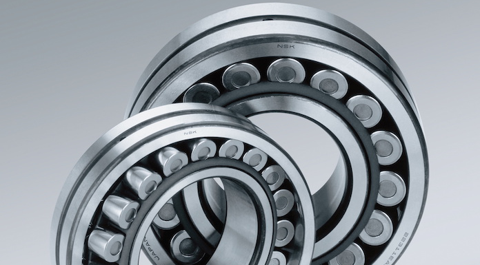

NSK EA series spherical roller bearings offer high load-carrying capacity and high limiting speeds in challenging conditions. Photo: NSK

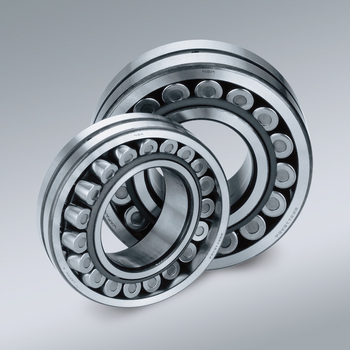

The customer duly replaced its existing bearings with high-quality NSK spherical roller bearings from the company’s EA series, as well as NSK spherical thrust roller bearings. EA series bearings, which feature pressed steel cages, offer high load-carrying capacity, high limiting speeds and high functionality under operating conditions involving elevated temperatures, making them ideal for the pellet extruder and other applications at the pet food plant.
