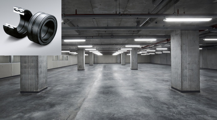

Repeat failures of the concrete floor manufacturing machine were of serious concern to the customer’s management team and a solution became an urgent priority. An investigation of the machine and its failed bearings by NSK’s expert team of engineers found that the main problem was with the cassettes, due to poor wheel design and the ingress of contamination (as a result of incorrect bearing specification). Arduous operating conditions are normal for this high-value construction process.
The solution was far from straightforward, requiring NSK to propose a complete redesign of the wheel hub and stub axle assembly, including a sealed roller bearing unit selected specifically for the machine’s loads. By incorporating NSK’s full-complement sealed bearing units, secured by circlips in the outer ring, it was possible to increase the load rating. Furthermore, integral seals provided greater protection for the bearings.
                NSK’s full-complement cylindrical roller bearing units with seals
The customer followed the proposals and produced a new shaft and housing to accept the redesigned NSK hub assembly.
NSK’s full-complement cylindrical roller bearings offer improved contact seals to prevent the ingress of foreign particles and water, a high load rating (radial and axial) and a corrosion-resistant phosphate coating to ensure suitability for external environments. The bearings are pre-lubricated with lithium grease and offer easy replenishment via inner and outer ring re-lubrication holes. If required, a snap ring (DIN 471) can be applied to the outer ring.
