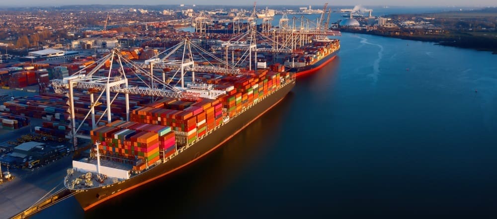

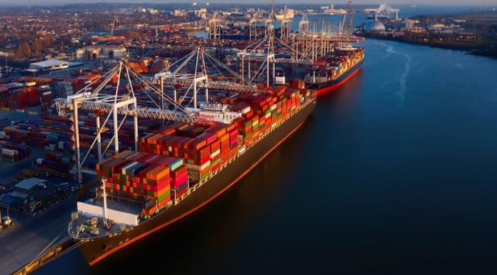

Ship loading conveyors are critical pieces of port infrastructure, where any downtime can prove extremely costly. Photo: Anita van den Broek/Shutterstock
