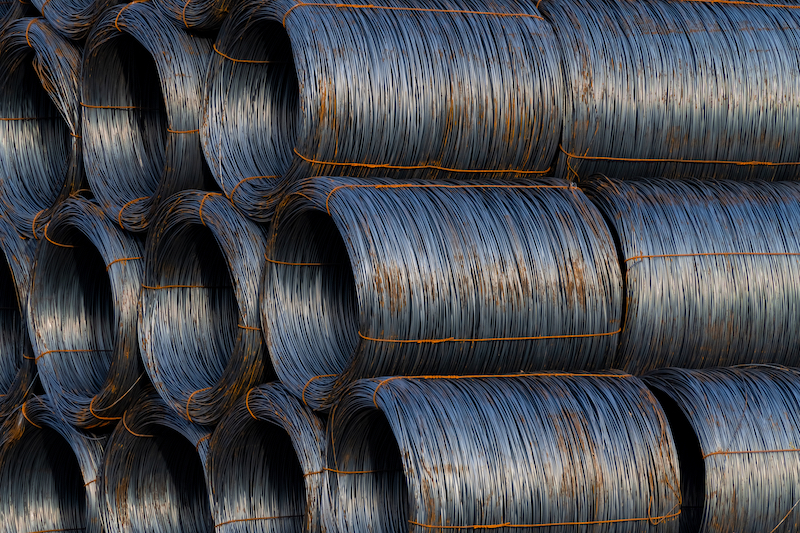

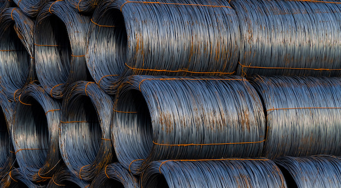

The steel wire manufacturer was enduring around 75 stoppages a month on average. Photo: Copyright (c) 2022 Photography Germany/Shutterstock
The bearing failures were leading to excessive downtime of around 75 stoppages a month, along with high maintenance costs, causing critical concern for the company’s management team. An urgent and robustly engineered resolution became a clear priority, which is why the steel wire manufacturer turned to NSK and its team of highly trained bearing experts.

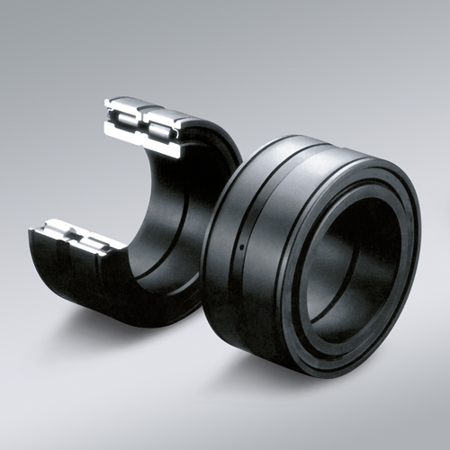

Relief arrived in the form of a new bearing and lubrication package recommended by NSK. As part of a value proposition, the solution consisted of an NSK sealed double row cylindrical roller bearing together with specially selected lithium grease.
NSK’s full complement cylindrical roller bearings are pre-lubricated with lithium grease. Photo: NSK
NSK’s full complement cylindrical roller bearings feature high-performance contact seals that prevent the ingress of contaminants or water. Further features include inner and outer ring re-lubrication holes for ease of maintenance, and a highly corrosion-resistant phosphate coating for use in external environments (if required). Pre-lubricated with lithium grease, the sealed units offer a high load rating for increased radial and axial capability.
