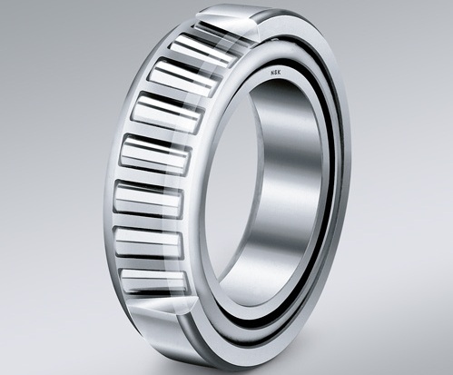

New cage design for tapered roller bearings
NSK’s tapered roller bearings are often used for the planetary carriers in the input stage of wind turbine gearboxes and for the rotor shaft. They can also be found in the so-called integrated rotor bearing, which pushes the gear unit and the hub together.
In the past, NSK used cages made from pressed, thick metal plate for these bearings. However, the ever-growing bearing diameter forced the company to find alternative solutions, so it developed a welded cage for diameters of 1,000 mm or more. The cage fulfils the highest technical specifications, but it is very complex to produce and requires advanced welding skills. For this reason, NSK is currently testing a plastic segment cage, which is cheaper to produce and can also be manufactured with a high level of reproducibility.
