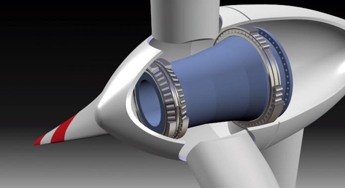

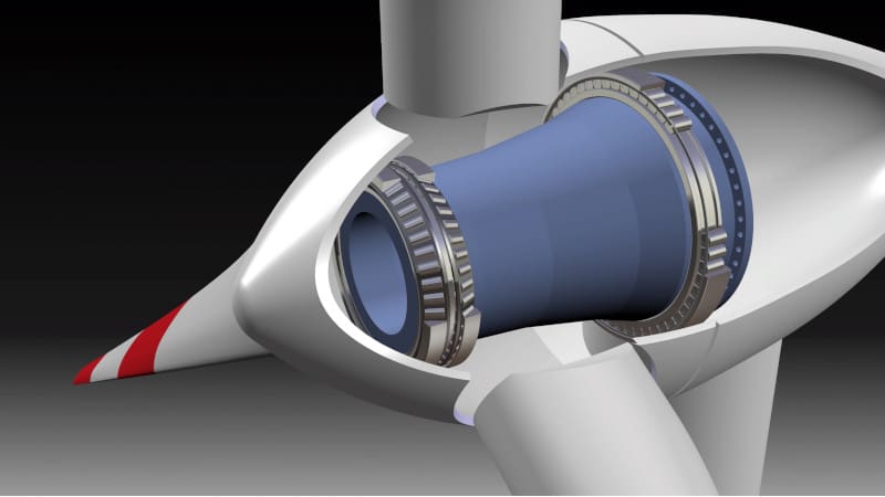

                                      Location of the main rotor bearings in gearless wind turbine systems

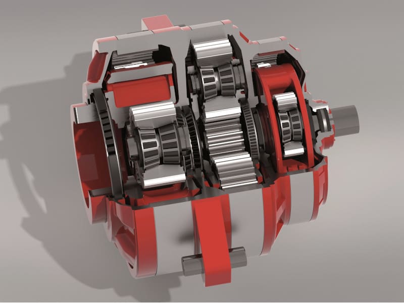

            A major trend in the wind turbine industry is the integration of planetary gear stages and multi-row bearings

Main bearings
These loads clearly have an influence on the choice of bearings. In direct-drive wind turbines, double-row tapered roller bearings are increasingly being chosen as the main bearing. Compared with cylindrical roller bearings, which were commonly specified in the past, tapered roller bearings offer the advantage of adjustable pre-load, which makes it possible to achieve higher system rigidity. Such bearings have inner diameters of up to 2.7 m, which challenges even state-of-the-art design and manufacturing concepts.
In the case of geared systems, the weight of the additional drive components is compensated by the fact that the generator can have a smaller design. There are different design concepts for the main rotor bearing in each power capacity class. Systems up to 5 MW usually employ spherical roller bearings, while for 6 MW and higher, the preference is for arrangements with two tapered roller bearings, or double-row tapered roller bearings combined with a cylindrical roller bearing.

Integrated bearings
In geared drive trains, gearboxes with two or three-stage planetary stages are common nowadays. Often these planetary stages are combined with a helical gear stage. For several years, the trend has been towards using so-called integrated planetary gears. For this application, NSK has developed (in close co-operation with the gear manufacturer) multi-row tapered and cylinder roller bearings without an outer ring. Thus, the bore of the planet wheels is used as the outer raceway of the bearing.
In some applications, four-row integrated cylindrical roller bearings are used. In combination with four planets per stage, one set of bearings includes a total of 16 rows. To obtain an even load on all bearings, the bore and circumscribed diameters for the whole set have very tight tolerances.

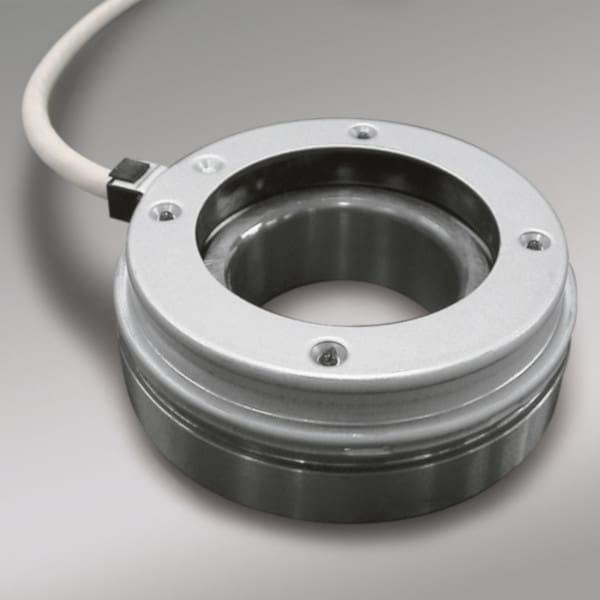

Bearings can be equipped with externally mounted or integrated sensors and linked to CMS (condition monitoring systems)

Applying condition monitoring
As a result of the fail-safe characteristics and long service life requirements, the bearings in wind energy systems are ideal candidates for condition monitoring systems (CMS), which use externally mounted or integrated sensors to continuously monitor the state of the bearing. Anomalies that indicate damage to the bearings can be detected and reported in a timely manner.
Modern-day CMS are deployed by offshore wind farms to detect abnormalities sufficiently early to allow the maintenance cycle of the system to be planned accordingly. NSK anticipates significant market potential for this type of system.
