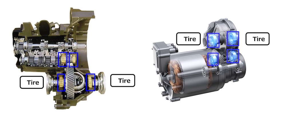

Tapered roller bearings are frequently used when there are low-rotation speed, high-load conditions on the tire side. Therefore, reducing the amount of friction in the roller bearings can help to increase the efficiency of the power train unit.
                                          Position of Tapered Roller Bearings in a Transmission and eAxle

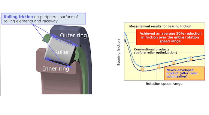

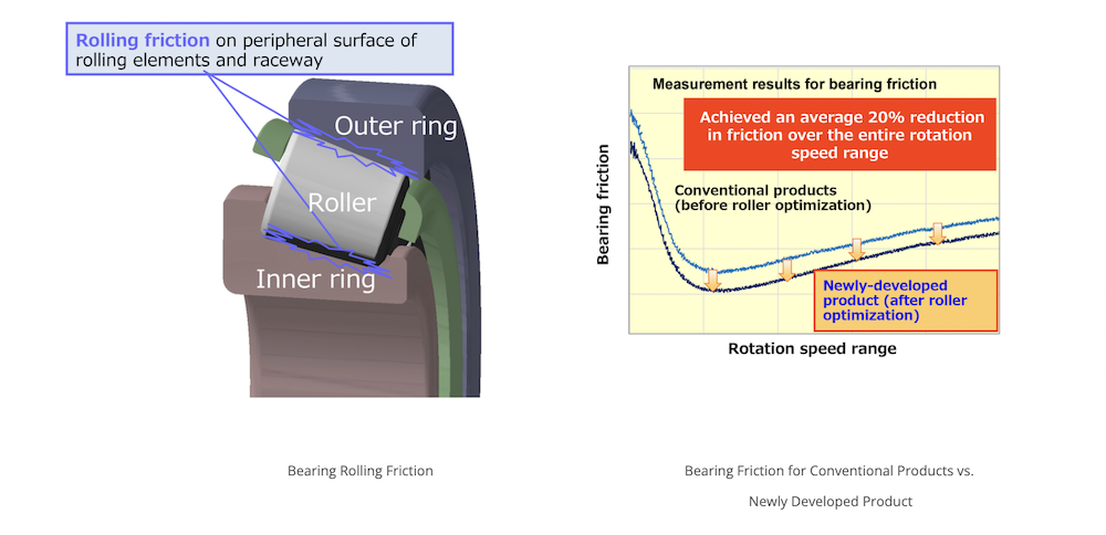

1) Optimization of the number of rollers reduces rolling friction, achieving an average 20% reduction in friction over the entire rotation speed range.

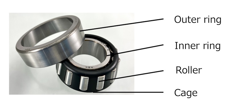

1) Optimizes the number of rollers in tapered roller bearings by focusing on service life
Tapered roller bearings have been found to be very durable against contamination, and to have a superior service life. Performing new tests, NSK confirmed their actual service life to be even longer than the calculated service life.
2) Resolves issues associated with optimizing the number of rollers
NSK has years of expertise related to special crowning technology and cages for lean lubrication conditions to solve problems, such as excessive surface pressure and seizure at the ends of the rollers, and has leveraged  this expertise to optimize the number of rollers.
