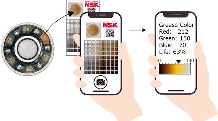

NSK is developing a world-first: a high-accuracy way of rapidly and accurately diagnosing the remaining life of lubricant grease. The company will provide the solution as a mobile app, enabling users to perform the on-site analysis of lubricant condition in bearings and linear motion systems. This innovative capability will reduce the need for grease inspection and replenishment costs, and help companies implement condition-based maintenance strategies. NSK’s is currently seeking customer input and feedback ahead of launching its new app.
                               The new NSK mobile app uses grease deterioration diagnosis technology

                                 The change in grease colour over time of use is clear to see
With these thoughts in mind, NSK set about developing a far more convenient, cost-effective, fast and accurate method of grease degradation diagnosis. Importantly, the new NSK app can analyse the level of lubricant degradation using just a small sample of grease. Chemical changes to the base oil and additives of the grease occur due to heat from operation and oxidation with the passage of time. These chemical changes cause the molecular structure of the lubricant to change and absorb more short-wavelength light, affecting its colour. Grease itself starts off white when new, turning yellow or orange with use and eventually becoming black, which indicates zero remaining life. The NSK app quantifies grease by its colour to calculate remaining life.
