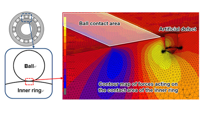

- 2. NSK Digital Twin technology used to establish rolling bearing life calculation method based on non-metallic inclusion size.
- To derive a bearing life calculation method based on the analysis of non-metallic inclusions, NSK developed a unique rotational testing method that involves introducing artificial defects simulating non-metallic inclusions of various sizes into rolling bearing raceways.
- We succeeded in reproducing specific modes of failure as intended and further created a simulation*3 capable of reproducing and analyzing the stresses around the artificial defects to futher clarify the mechanism of flaking fatigue.
Based on this we successfully developed the world’s first*4 method for calculating rolling contact fatigue life based on the size of non-metallic inclusions in steel.
