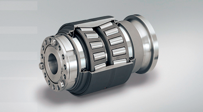

An NSK tapered roller bearing unit for railway applications featuring a pressed steel cage
Only the highest quality engineered bearings are suitable for the axle-box assembly found on trains that travel at speeds of up to 320 km/h. NSK can already claim success in several notable European high-speed rail projects with the company’s RCT sealed-clean rotating-end-cap tapered roller bearings. RCT (Railway Cartridge Tapered) bearing units demonstrate key attributes that include reliability, long service life and safety. With innovative sealing solutions to ensure durability and optimal performance, these advanced bearing units accommodate high shock loads, axial loads, and static and dynamic radial loads.
