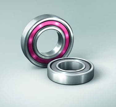

NSK bearings deliver a guarantee of greater durability, speed and reliability, all of which serve to increase machine productivity and performance in paper mills worldwide. An example of this is in the wire section of modern papermaking facilities, water ingress together with the demand for ever-greater speeds can prompt premature bearing failure and potential production line stoppages. However, NSK can offer an innovative solution in the form of its Molded-Oil bearings, which are particularly effective in environments exposed to dust and/or water contamination. Alternatively, where ultra-high speeds are required, NSK has assisted numerous wire sections with its HPS range of spherical roller bearings.
nsk-paper-19012016-cnt1
NSK Molded-Oil bearings are especially effective in environments exposed to dust and/or water contamination.
