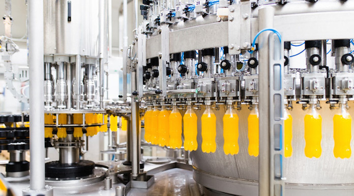

              A manufacturer of PET bottles is benefitting from NSK RA series roller guides on its blow moulding machines.               Photo: Shutterstock
