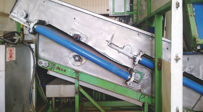

                   The baby leaf harvester features numerous bearing units to support shafts of various diameters

Excellent protection against corrosion, chemicals and detergents ensures Silver-Lube® can endure challenging operating conditions at food plants around the world. A case in point is a facility that processes baby leaf products for sale to leading supermarkets. Here, the leaf harvester machine previously featured numerous low-cost mounted-unit bearings to support shafts of various diameters. Unfortunately, the machine was prone to ongoing failures due to the ingress of dirt and water into its bearings. The upshot was recurring production downtime and, on occasions, ruined crops.
Excellent protection against corrosion, chemicals and detergents makes Silver-Lube® highly attractive to food plants
NSK experts accepted an invitation to review the application and operating conditions. This appraisal process ultimately led to the replacement of the existing mounted units with Silver-Lube® featuring an innovative flinger seal arrangement and stainless steel bearings. During the subsequent harvesting season, just two bearing failures occurred, improving productivity and generating savings of €63,300 thanks to significantly lower production losses.
