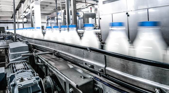

                          The milk bottling plant was enduring conveyor bearing failures every 16 weeks on average.                                                                                    Photo: 279photo Studio/Shutterstock
Among those testifying to the advantages of Silver-Lube® is a market-leading milk processing and bottling plant. The facility was experiencing repeated bearing failures on five conveyor lines, where the company was changing bearings approximately every 16 weeks. With every replacement taking approximately one hour to complete, the plant invited NSK’s team of experts to recommend a solution.
As part of its AIP Added Value Programme, NSK’s specialist engineers analysed the failed bearings, concluding that the ingress of water during the wash-down process was causing internal corrosion and premature failures. Further review of the application and operating conditions led the NSK team to recommend its proven Silver-Lube® housed bearing units.
The high sealing performance and corrosion protection provided by NSK Silver-Lube® housed bearing units have extended service life to more than five years. Photo: NSK
The plant commenced a trial of Silver-Lube® bearings featuring food-grade grease on one of its bottling line conveyors, a solution that resulted in an immediate improvement and significant lifetime extension.
Silver-Lube® features durable and heat-resistant silicon rubber seals that protect against fluid penetration and prevent washout of the lubricating grease. Complementing the seal is a stainless steel flinger, which prevents the ingress of bacteria and helps the seal to resist impact damage. Silver-Lube® bearings also comprise numerous corrosion-resistant components, including inserts with high-grade stainless steel rings and balls, cage, flingers, and set screws. Furthermore, the bearing insert sits within a high-strength PBT thermoplastic housing featuring a stainless steel grease nipple.
After the initial trial, the plant implemented Silver-Lube® housed bearing units on all five of its milk bottle conveyor systems. The result: a reduction in machine downtime, maintenance labour and replacement bearings costs, leading to annual savings of €7,625. Indeed, no failures of Silver-Lube bearings occurred for more than five years.
