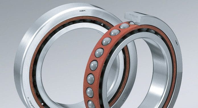

NSK Super Precision Angular Contact Ball Bearings offer long-life, high-precision and low-noise characteristics to suit high-speed machine tool spindles
