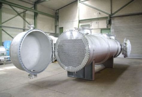

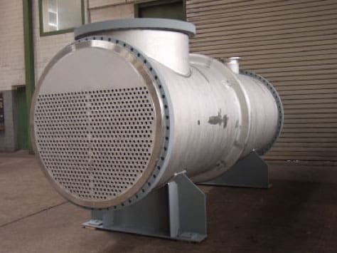

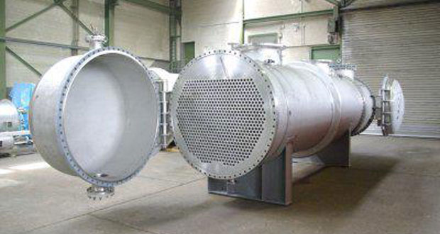

When a manufacturer of heat exchangers was experiencing frequent production stoppages due to bearing damage on the spindles of its horizontal machining centers, the company turned to NSK for a solution. After comprehensive analysis, NSK recommended fitting its sealed, high-precision, angular contact ball bearings, a move that is helping the facility to save €24,000 per annum in replacement bearings and labor costs alone. Horizontal machining centers are used frequently in the production of industrial heat exchangers.

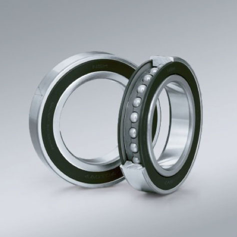

To overcome the issue, NSK proposed the use of its sealed, high-precision, angular contact ball bearings, which are deployed widely as spindle bearings in the machine tool industry. These bearings have contactless seals that are designed to deliver exemplary resistance to the penetration of contaminants without causing friction to increase, or spindle performance to drop.
To help accommodate the increased axial loads exerted on spindles often present in horizontal machining centers, a further suggestion from NSK was the installation of bearings with a higher contact angle. As a result of adopting this recommendation, the heat exchanger manufacturer has been able to increase the operational life of the bearings: after fitting NSK bearings to three of its horizontal machining centers, spindle bearing operating life increased on average by a factor of 12.
