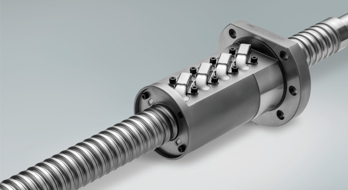

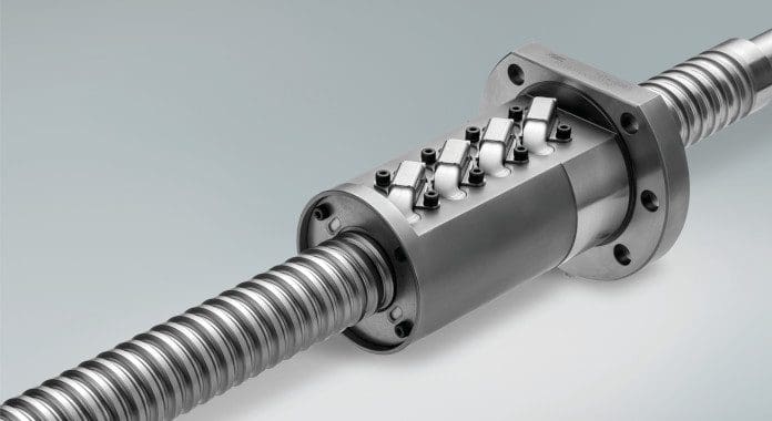

The NSK showcase at EMO Hannover will be headlined by the recently introduced DIN-standard ball screws, which are designed to offer high-speed and high-load capacity, as well as low noise. In fact, 1.4 times dynamic load rating can be achieved thanks to the use of NSK´s proprietary TF bearing steel.
Also in the spotlight will be NSK´s new range of high-durability precision ball screws, which make use of newly developed surface processing technology to reduce wear and realise maintenance-free operation for longer intervals. A special surface texture is applied to the raceways to greatly enhance oil film formation. It is typically difficult for a satisfactory oil film to form during low-speed, short-stroke, oscillating type operations. However, even under such conditions, high-durability precision ball screws are three times more resistant to wear than standard NSK products. The ball screws are ideal for machining centres that perform high-accuracy operations, such as mould and die machining, as well as EDM (electrical discharge machining) machines.
