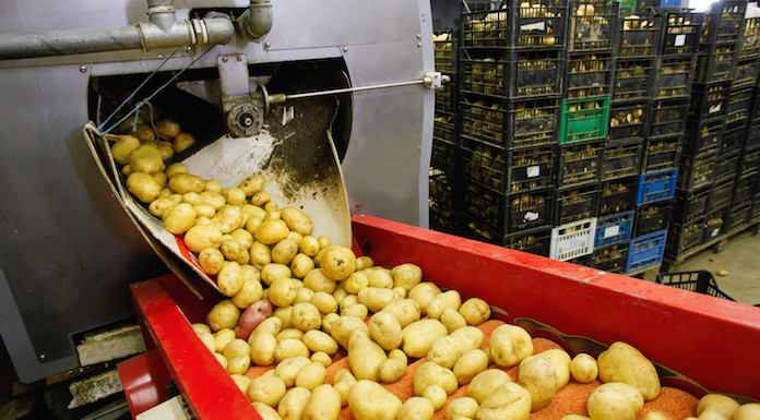

In barrel washers for vegetables, bearings submerge in water with every rotation of the drum. Photo: iStock.com/zlikovec

Among a growing number turning to Self-Lube® bearing units with triple lip seal is a manufacturer of barrel washers for cleaning vegetables prior to processing or packaging. The barrel washer’s bearings submerge in water with every rotation of the drum. Due to water washout and corrosion it was proving necessary to replace the bearings every three months. To avoid this costly exercise, the company invited NSK’s expert team of engineers to investigate the problem.
After a full application review and bearing failure analysis, NSK recommended its Self-Lube® bearing units with triple lip seal, which are perfect for applications where bearings face exposure to water contamination. The solution produced a significant lifetime extension to more than 7 months (at least 133% improvement). As a result, the manufacturer of barrel washers is saving €56,600 in bearing replacement and maintenance costs over every six-month period of operations.
