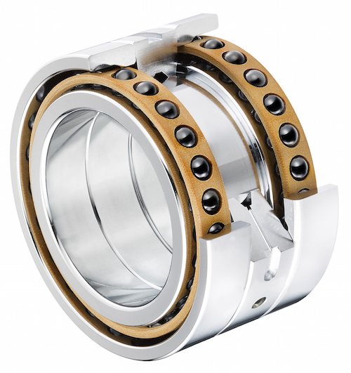

Sensor integrated bearing unit for machine tools
When using machine tools, reducing Total Cost of Ownership (TCO) is a critical
factor for businesses. NTN has developed a sensor unit which is mounted near the high precision bearings to monitor the bearings in the main spindle. How does this work? The developed bearing unit consists of two high-speed bearings (HSE series) and two spacer sleeves, which are located between the two bearings. Within the outer spacer sleeve three different types of sensors are installed. These sensors measure vibrations that occur, heat flow and the temperature of the two bearings with very high precision. Thus, with the help of defined limits, a critical condition can be detected much earlier and unnecessary damages can be avoided.
Machine Tool Main Spindle Bearings with Air Cooling Spacer
With the air-cooling spacer technology, NTN has also developed a solution that makes it possible to further increase the limits of the standard preloaded bearings or even to challenge the usual spring preload.
The system consists of at least two bearings that can be mounted with a specified preload in an O-Arrangement or Tandem O-Tandem Arrangement. In doing so, normal compressed air flows on the inner spacer, which is located between the bearings, whereby the temperature delta between the inner ring and the outer ring is reduced. Depending on the respective volume, the temperature delta can thus be reduced by more than 10 degrees. This makes it possible for the designer to increase the initially selected preload or to increase the speed. The fixed-preloaded bearing unit makes it possible to achieve speed characteristics dmxn up to 2.1 million and at the same time to increase the preload (greater than 1.000N for a 7014 bearing).
