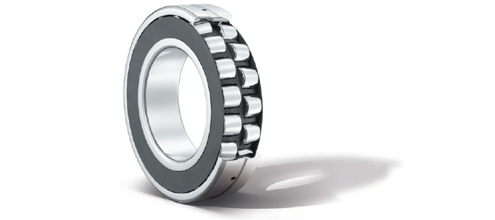

A spherical roller bearing protected by metal shields attached directly to the cage. The idea may seem simple, but it presented a significant challenge in terms of design and manufacturing. Provide protection against solid particles (dust, pebbles, etc.), improve grease retention, respect ISO dimensions – and all of this without reducing the load capacity and rotation speed or minimising the possibility of misalignment. These were the main considerations when the KIZEI® range was being designed in Annecy, France, then manufactured in Italy by NTN-SNR.

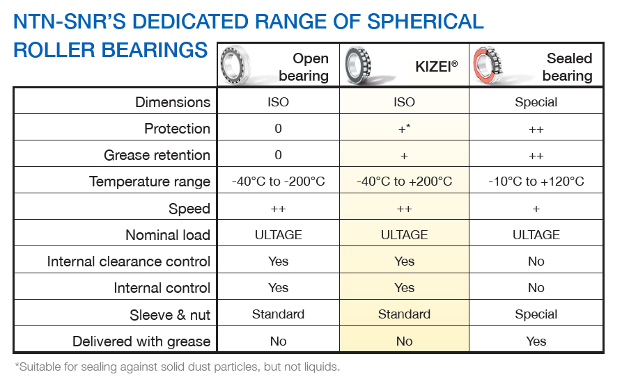

- ULTAGE label
- Load capacities and rotation speed identical to an ULTAGE open bearing
- ISO standard dimensions
- Nitrided shield and cage for greater impact resistance
- Temperature range from -40°C to +200°C
- Initial lubrication identical to an open bearing
- Optimal misalignment
- Simple mounting on cylindrical or conical to tapered
