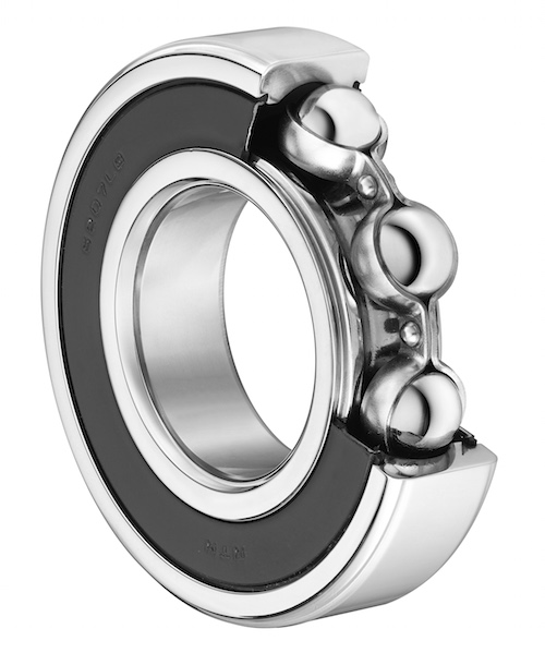

NTN deep-groove ball bearings with CM internal clearance were originally designed specially for electric motor applications which require particularly quiet bearings. These CM bearings feature radial internal clearance that lies within the limits of normal internal clearance, but with reduced clearance tolerances (for example, for a bore diameter of 50 mm, a bearing with normal internal clearance would have clearance of 6 to 23 microns, whereas a product with CM internal clearance has one of 9 to 17 microns).
This innovative technical characteristic significantly reduces the bearing’s vibration levels and, therefore, the noise that it makes when in operation. Laboratory tests reveal a reduction of up to -3 dB: a noise level reduced by half when compared with conventional standard-clearance products.
CM clearance is obtained thanks to excellent control of the manufacturing process and NTN’s recognised know-how. Every part we manufacture is inspected to guarantee clearance and noise levels.
