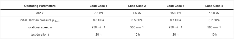

2.1. Load Cases, Material and Lubricant Properties
In order to allow qualitative comparability with the experimental results from literature, the wear calculations were carried out by means of a thrust roller bearing 81212. Four load cases with the speeds, simulated test durations, axial loads and initial Hertzian pressures in the roller/raceway contact (assuming a pure line contact, i.e., without profiling) according to Table 1 were studied. Thus, each washer surface element experienced a constant number of 2,850,000 overrollings.
Moreover, a realistic velocity distribution was taken into account, whereby u1 was considered as the relative velocity of the washer in the rolling x direction:
The roller maintained a constant peripheral speed of:
Perpendicular to the rolling direction, the washer had a relative velocity of:
whereas the roller had no velocity component in the y direction:
Underlying geometry and coordinates are illustrated in Figure 1.

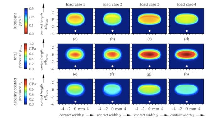

3. Results and Discussion
Due to the roller radius in and the logarithmic profile perpendicular to the direction of motion, the initial conditions featured typical characteristics for elliptical EHL contacts with a horseshoe-shaped lubricant gap (Figure 5a–d), a total pressure distribution similar to Hertz (Figure 5e–h) as well as a constriction in the film height as well as a barely pronounced Petrusevich spike in the outlet region. Due to the smaller contact area, the pressures exceeded the Hertzian values determined for a perfect line contact (Table 1). In addition, the speed profile (Figure 1b) resulted in a slight asymmetry and tilting of the contact area. The clearly recognizable asperity contact pressure (Figure 5i–l) followed the lubricant height in shape and indicated an operation under mixed EHL conditions. The effects of the load case and oil on the lubricant gap and the pressure formation basically corresponded to theoretical expectations.Higher speed (load case 2) and higher viscosity (Figure 6) led to a larger and higher load (load case 3, 4) to a lower fluid film height. Accordingly, the asperity contact pressure behaved just oppositely. Moreover, the higher load led to a significantly larger elastically deformed contact area. It should be noted that although the contact width y was scaled in the same way for all cases, the contact length x was plotted normalized to the Hertzian width for reasons of reduced space requirements. Thus, the contact area actually expanded further in the x direction at higher loads as well.
The continuous progress of the simulated time led to material loss and changes of the surface topography of the washers and the rollers. In brief, the wear-depth distribution, as depicted in Figure 7, followed the product of asperity contact pressure and sliding velocity. The inner (negative y values) and outer halves (positive y values) of the raceway showed a slightly asymmetrical shape due to different velocities. Thereby, wear was higher in the area of the negative slip. This stands in good agreement with the experimental results from Terwey et al. [13,14]. Despite differences in absolute values due to the less severe conditions (lower loads and higher velocities) and the operation being in the mixed instead of the boundary lubrication regime, the qualitative profiles agree well. Furthermore, a more significant difference in the wear depth between the inner and outer halves of the raceway could be found on the washer. This was due to the fact that the calculated wear volume was distributed over a smaller circumference at the inner half of the raceway than at the outer area. Higher loads and lower sliding velocities resulted in a higher wear depth. This can be explained by lower lubricating film heights resulting in higher asperity contact pressures. For the same reason, the use of a lower viscosity oil (FVA1) compared to a higher viscosity oil (FVA 2) led to higher wear depths.
The PDF of the asperity heights were further applied to the calculation of the asperity contact pressures, which were a prerequisite for the application of the mixed friction model based upon the load sharing concept. As can be seen in Figure 9, the contact pressures were shifted to the bottom left with increasing simulation time, which was caused by the worn-out asperity peaks in terms of the modified probability density functions.Furthermore, in most cases the asperity contact pressure curves also reached a stationary state with slight differences to the final state being distinguishable for less harmful cases, see for example Figure 9f).
Changes in the surface topography were also accompanied by transformations of the lubrication conditions, see Figure 10, Figure 11, Figure 12 and Figure 13. In addition to the horseshoe-shaped constriction of the lubricant gap at the contact outlet region, there was a similarly pronounced minimum along the y = 0 axis. This was due to the low wear in this area, despite the high total and asperity contact pressure, since the conditions of the pure rolling (slide-to-roll ratio (SRR) = 0) prevailed. Furthermore, the asymmetry and slight tilting resulting from the speed and wear profiles could still be observed. Generally, the distributions of the lubricant gap and the pressure continued to correspond to the principles of the influences of speed, load and viscosity. In most cases, the fluid and pressure distribution only featured small differences between the half and end of the simulation time. While some load cases still showed significant asperity contact pressure after the simulated runtime, see Figure 12i,k), others indicated a kind of completed running-in process with hardly any solid contact compared to the initial state, see for example Figure 13l).
