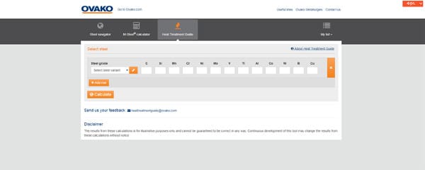

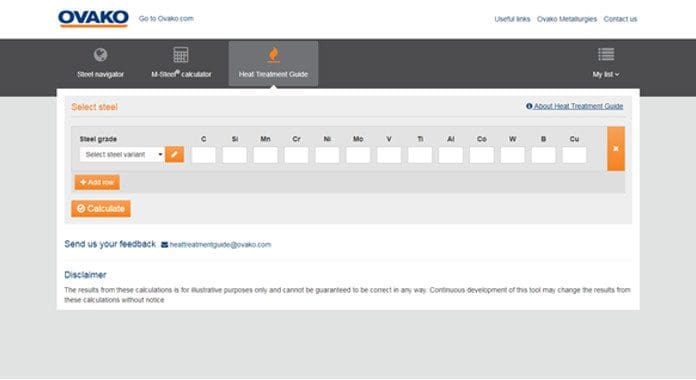

Ovako’s Heat Treatment Guide provide the customer with a unique service to help choose the right steel for their specific application. By choosing a steel grade composition in the Heat Treatment Guide, users will be able to predict how a steel of a specific composition will perform after heat treatment. The user can alter the steel compositions to investigate the impact of different alloying elements. Customers then can compare different steel compositions by layering them in the resulting graphs.
“The primary information provided by the Heat Treatment Guide is the hardness that can be achieved as a function of the cooling rate when the steel is quenched, which presented as a CCT-diagram and a Jominy curve. Secondly the tempering diagrams show how hardness and tensile strength vary as a function of the tempering temperature. A table also details the core hardness after quenching of bars in diameters ranging from 5 up to 500 mm using water, oil or air as the quenching medium,” says Joakim Fagerlund, the developer of the Ovako Heat Treatment Guide.
