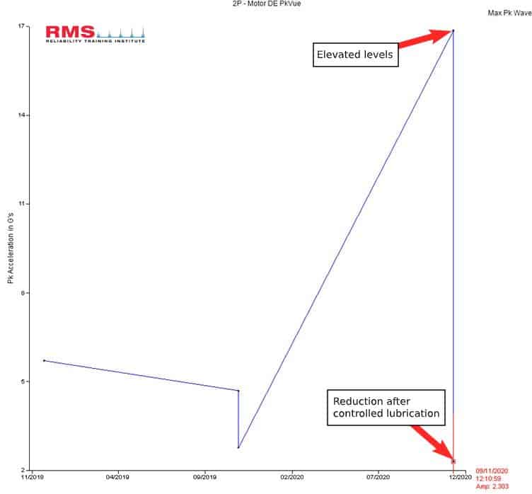

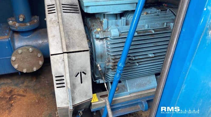

On a recent survey of a critical 110KW blower motor we noticed the PeakVue levels had increased. While at the machine we quickly ran the PeakVue plus and this highlighted the issue as a poor lubrication condition.
Instead of writing this in the report then living in hope the motor is correctly greased, we showed this at the machine to the site fitter and we were immediately permitted to lubricate the bearings and the levels reduced.

                                                          Image of the 110KW critical blower motor

                                                    Max PeakVue Trend
