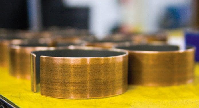

Plain Bearing Manufacturing
Metal-polymer bearings are produced using a series of technologies that combine the steel or bronze metal backing, bronze powder, and polymer liner. To start, a coil of backing metal is fed through a machine that applies bronze powder to one side through the use of heat—a process known as “sintering.” The sintered strip is then cooled and ready for impregnation. Impregnation is the application of a polymer liner onto the sintered strip and can be done with the polymer in either mush or tape form. According to Evans, “For GGB’s self-lubricated bearings, a mechanical arm drops the polymer onto the sintered strip, which is then rolled out through downstream machines to create a smooth self-lubricating liner. GGB pre-lubricated bearing liners are made with a polymer tape that is applied directly onto the sintered strip.”
The impregnation process for both forms of polymer includes a series of mill-rolling, heating, and cooling operations in order to create a smooth-surfaced metal-polymer strip. After impregnation, the strip is finished and coiled for later shaping into bearing products. As Evans explains, “This shaping process utilizes roll-forming or pressing, depending on the bearing size, to create a smooth, cylindrical-shaped product.”
FRC bearings are manufactured through a winding process that utilizes automated winding machines. For bearings with the liner on the inside diameter, the liner material must first be applied to the length of a mandrel. For wound liner products, this is done by a winding machine that is continuously fed strings of high-strength fibers encapsulated in an internally lubricated epoxy resin. For tape liner products, a PTFE tape is applied on a mandrel. After this base liner is applied, the fiberglass backing is wound around the mandrel through the use of automated winding machines. Once this backing reaches the required thickness, the mandrel is removed and later cured in an oven. This process hardens the winding around the mandrel into a solid tube. At this point, the inside diameter is smooth and finished while the outside diameter is rough and oversized. In order to finish the outside diameter, it is ground down to its desired final size. The tube is then cut to produce multiple finished bearings whose edges are deburred as needed. “The length and diameter of the mandrels used in this process can vary,” Klepach says, “to achieve different dimensions based on customer need.”
