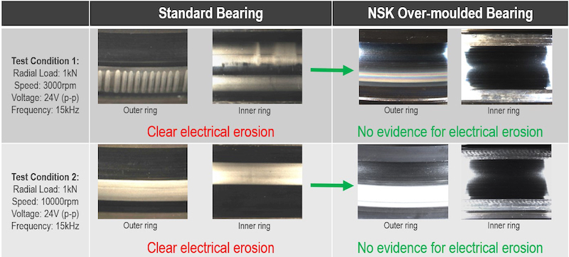

                   NSK tests reveal the success of the over-moulded bearing innovation against standard NSK bearings

Comprehensive NSK tests reveal the performance of the over-moulded bearings in comparison with the company’s standard bearings. For example, at 24V voltage and 15kHz frequency, standard bearings showed clear electrical erosion of the inner and outer rings. In contrast, the new NSK over-moulded bearings demonstrated no evidence of this phenomenon. The same outcome resulted at various rotational speeds.

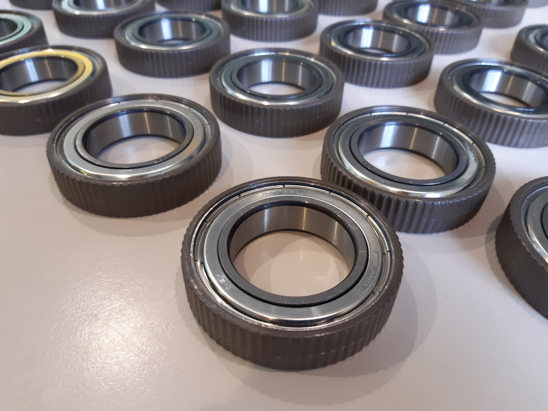

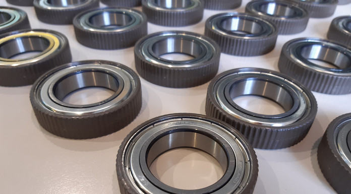

Production of the over-moulding comes courtesy of an innovative injection moulding process located at an NSK facility in Europe to optimise supply to the EV industry. Special mould features ensure homogenous distribution and orientation of the molecules and glass fibres to optimise mechanical performance. Notably, the precision of the over-moulding means there is no requirement for grinding, leaving a ‘structured’ finish in place. As a result there is not 100% contact between the housing and the outside diameter of the bearing, creating gaps filled with air. Air is a good isolator and costs nothing. This innovation provides market differentiation for the NSK solution. As a further benefit, the structured finish overcomes the established issue of bearing creep within housings, as it potentially provides a better fit due to multiple contact points (depending on the use case).
Applicable on the inner and outer ring, the patented insulation layer will usually range from 0.7 to 1.2mm in thickness. To accommodate the extra material NSK can offer space-neutral solutions. This is easiest when starting a new bearing design, although NSK can also machine material from the outer diameter of existing bearings accordingly. However, there is a cost element to this solution. As an alternative proposal, OEMs can look to open up the housing that accommodates the bearing, which means NSK will not have to change its process. Taking this pathway allows EV manufacturers to take full advantage of the significant cost savings available in comparison with hybrid bearings.
At last, the EV industry has a cost-effective solution that negates the electrical erosion of bearings in electrified drivetrains. The over-moulding is currently applicable to NSK’s 6008 and soon for its 6206 deep groove ball bearing series (sealed and non-sealed), which are ideal for EV applications.
