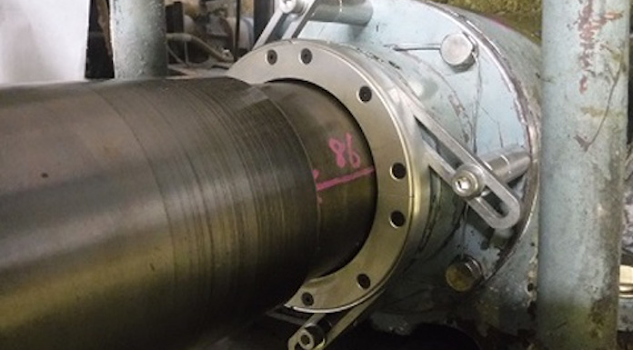

Finally, in May 2020, they tried the AEGIS® PRO ring. They installed one PRO ring on each of the bearing bases that support the rollers. The second image shows a PRO ring installed on the bearing base.
The AEGIS PRO Shaft Grounding Ring, developed by Electro Static Technology, in Maine, USA, electrically connects a machine’s rotating parts to their stationary parts. This is done with thousands to millions of conductive microfibers placed positioned around the entire circumference of the shaft or roller. AEGIS rings are most often used on motors controlled by inverters (variable frequency drives). Rather than arcing through the bearings, any charge on the rotating element travels to the frame through the low-resistance AEGIS ring.
As mentioned above, before May 2020, bearing replacement was carried out frequently, with an average failure interval of 404.4 days and a minimum of 92 days. As of October 2022, the failure interval is over 850 days… and counting!
