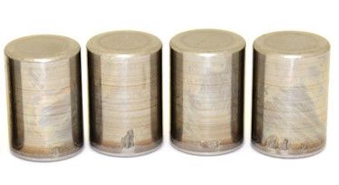

During a recent testing project, a full complement of roller bearings subject to a significant amount of misalignment in the application were to be tested. In order to choose the testing conditions, the raceway profiles were measured and then used to calculate the pressure distributions and bearing life in the application according to ISO 26281.

Figure 4 shows the local stress distributions at testing conditions that are representative of the real application. Based upon these simulation results, the test runs were performed using the same parameters. The measured lifetimes are overall higher than the calculated lifetime (Figure 5). The bearings in question therefore fulfill the requirements and the supplier was approved.
The approach followed here – utilizing simulations to inform test parameter selection – ensures that testing conditions are actually representative of the particular application characteristics, without exaggeration or underestimation. This is especially important when, as in this application, significant misalignment between the bearing rings is expected.
