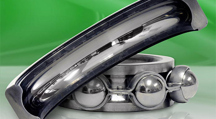

But VFDs have their drawbacks.  They can induce voltages on the shafts of the motors they control.  Without an alternate path to ground, these VFD-induced voltages (and high-frequency circulating currents) will discharge through motor bearings causing electrical discharge machining (EDM) that blasts pits in bearing and race surfaces. This process eventually leads to frosting and fluting (washboard-like ridges on the bearing race), and bearing failure — often in as little as 3 months!
