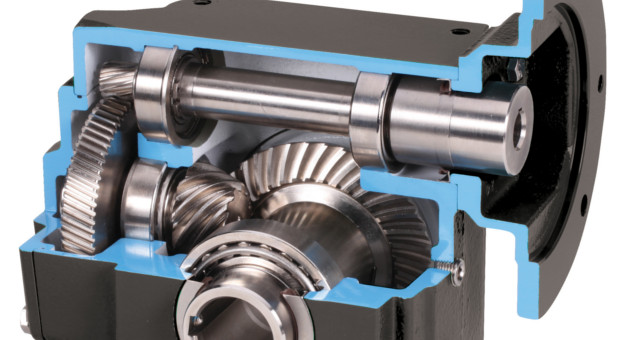

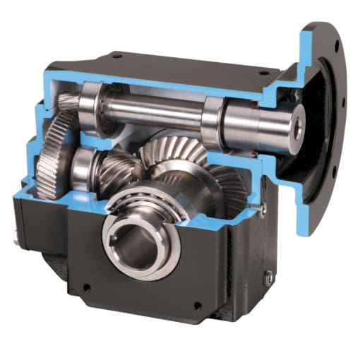

Quick-delivery shaft-mount and concentric reducers
Hub City’s PowerTorque shaft-mount reducers will be displayed in cutaway to highlight the carburized and ground, AGMA-11 gears that provide exceptionally high torque density in a compact package, with up to 98.5 percent efficiency per stage. These versatile units are ideal value-priced drop-in replacements for applications such as bucket elevators and bulk conveyors. A wide range of accessories includes conversion kits for screw conveyor applications. Warranted for 18 months, they feature metal-reinforced double-lip seals riding on precision-ground shafts to deliver long service life. Ready for off-the-shelf delivery, PowerTorque reducers are available in 10 sizes up to 200 hp rating, with output speeds to 200 rpm.
48-hour shipment is available on the most popular sizes and ratios of Foote-Jones Line-O-Power™ helical concentric-shaft reducers. A cutaway display at AGG1 highlights the rugged housings, high-capacity bearings, ground/skived gears and large diameter shafts. Double-, triple- and quadruple-reduction units are available in ten sizes up to 1550 hp input and 429,300 in-lb output. Surface-hardened helical gearing is rated to AGMA standards, and tapered roller bearings on all shafts provide anticipated bearing life in excess of AGMA standards. Models available in the Fast-Foote 48-hour delivery program include double and triple reduction units rated for up to 200 hp continuous input.
Browning’s multi-patented TorqTaper® Plus helical shaft-mount reducers allow easy installation from front or rear for compact installations with short shaft lengths. A patented three-layer barrier seal is key to the reducer’s industry leading three-year warranty. Available for up to 500 hp input, the TorqTaper reducer features carburized, ground AGMA-12 gearing and tapered roller bearings on all shafts, providing high torque densities that allow downsizing in many applications. Larger diameter shafts also allow high overhung loads.
