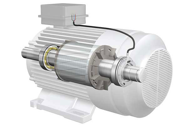

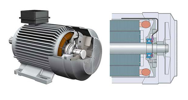

Fig. 1: Exploded view of an AC induction motor incorporating an SKF Motor En-coder Unit, BMD.
The latest development in sensor bearing design is the SKF Motor Encoder Unit, BMD (fig. 1). It has been developed to meet the requirements of a number of applications such as electric vehicles (fig. 2), forklift trucks (fig. 3), materials handling and agricultural (fig. 4), forestry and construction machinery. The new encoder unit meets the demands for reliable performance with a compact and robust design that offers greater resistance to magnetic and electromagnetic fields for improved up-time and reduced warranty costs.

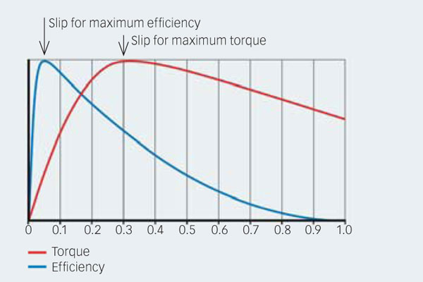

AC induction motors incorporate a frequency converter. The frequency converter creates alternating current with a variable frequency in the stator coils, which induce a current flow and magnetic field in the rotor. This induction needs a stator frequency higher than the rotor speed, the so-called slip. Induction motors cannot run at synchronous speed (stator field and rotor at same speed) as no rotor torque would be created. The maximum torque and motor efficiency is also a function of the slip (fig. 6).
Fig. 6: Motor efficiency and torque versus rated slip.

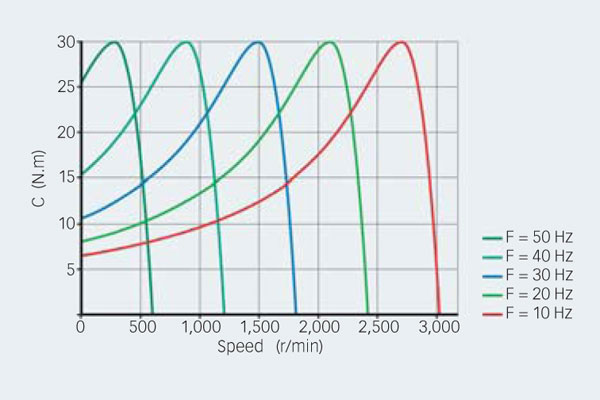

By varying the stator frequency and controlling the slip, i.e., the rotor speed with a feedback sensor, such as the SKF Motor Encoder Unit, the motor can run with maximum torque at different speeds (fig. 7).
Fig. 7: Motor torque at different speeds by varying stator frequency and controlled slip.

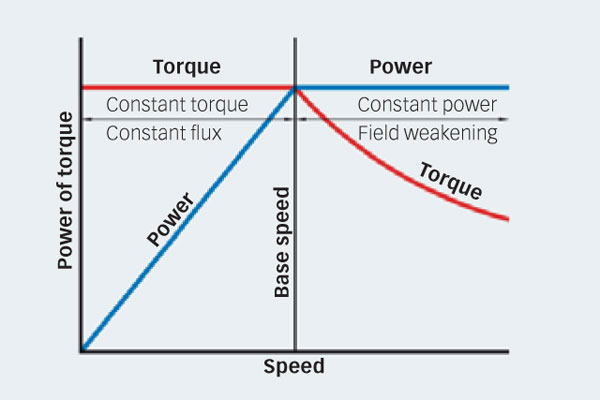

Traction motors in forklift trucks also run above the base speed. As a consequence, not to exceed the maximum power, the torque of the motor needs to be reduced (fig. 8).
Fig. 8: Adjustment of motor torque as a function of maximum power.

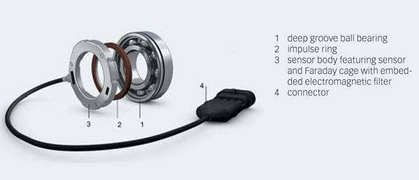

Increased robustness in both mechanical and electromagnetic environments, then, is at the heart of the design parameters. The BMD series incorporates 6206 SKF Explorer deep groove ball bearings that are defined by their small size, high performance and long life, equipped with a robust sensing technology (fig. 10).

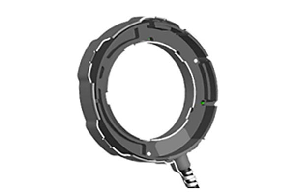

Fig. 10: Exploded view of SKF Motor Encoder Unit, BMD.

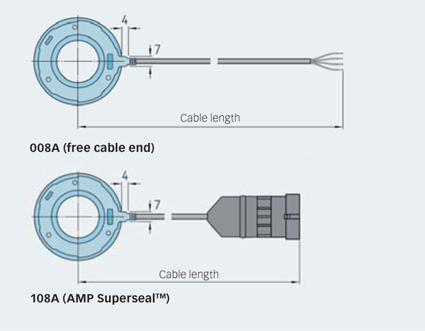

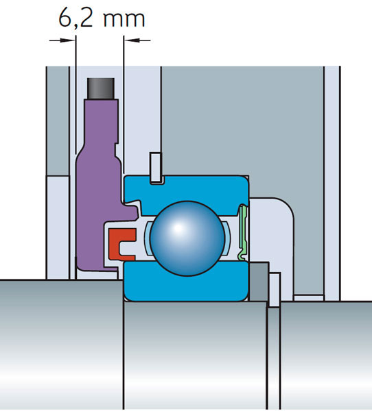

The encoder unit is available in two standard executions, either with or without an external connector (fig. 11). One of the benefits of the new design is that it can be used as a direct replacement for SKF’s previous sensor bearing designs, the BMB and BMO, without modification. As well as being fully interchangeable with these previous models, the BMD design supports automatic handling for ease of assembly and lower production costs. As the SKF Motor Encoder Units are compact, only a small amount of additional space, 6.2 mm, is required to accommodate the sensor technology (fig. 12). This is particularly useful for forklift truck applications, for example, where space is limited.
Fig. 11: The unit is available as standard with or without connector.
Fig. 12: SKF Motor Encoder Units require only 6.2 mm of extra space to accommodate sensor technology.

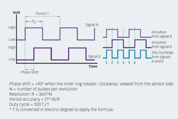

SKF Motor Encoder Units use Hall effect technology to produce an incremental encoder signal. Sensors based on the Hall effect are essentially transducers that vary their voltage output in the presence of a magnetic field. An impulse ring, which attaches to the inner ring of the bearing, is a composite magnetized ring that contains a number of north and south poles. The number of poles depends on the size of the bearing. The sensor body, which is attached to the outer ring, protects the SKF Hall effect cell. The sensor is accurate down to zero r/min. The sensor body contains both the control electronics and the Hall effect cell that produces an output signal consisting of two square waves (fig. 13).
Fig. 13: Signals information indicates direction of rotation and speed.
The signals can be interpreted by motor controllers as required. For example, the direction of rotation can be determined from the phase shift, when the rising edge of a signal first appears. Slow speeds can be obtained by measuring the time between two electrical events, events being the rising and falling edge on either square wave. High speeds are measured by counting the number of electrical events within a given time period.
The two square waves are 90 ° out of phase with each other. This phase shift changes sign with the direction of rotation. The presence of two signals in quadrature enables a processing unit to multiply the number of angular position increments per revolution. For example, using a standard SKF sensor bearing with 64 pulses per revolution and a standard electronic interface that can detect the rising (Low/High) and falling (High/Low) times of each of the two signals, it is possible to obtain 256 electrical events per revolution, which translates to an angular resolution of 1.4 ° (fig. 13).

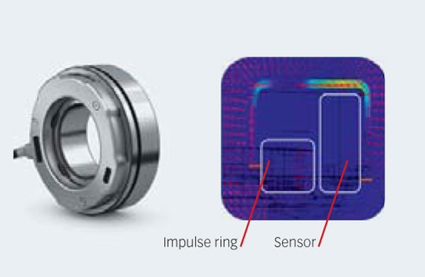

This design, protected by five patents, is also supported by new protective technology, one mechanical and one electronic, that further improves the robustness of the system. This is particularly important to protect sensor bearings against voltage peaks, which may cause problems for the sensor electronics. The mechanical protection for the sensor bearing is achieved by a Faraday cage that is formed by the outside of the sensor body, which provides an efficient physical shield against external magnetic fields (fig. 14).
Fig. 14: New steel casing protects the sensor.
