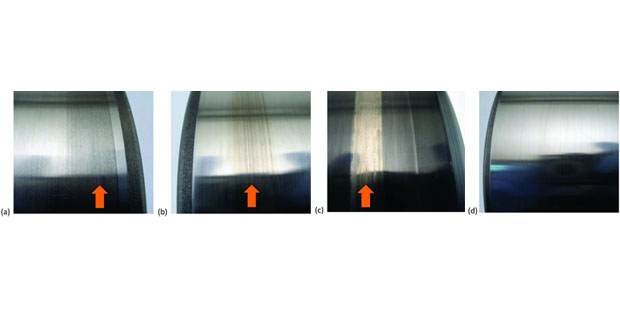

Smearing damage was created on test CRBs by alternating the load zone direction according to a square wave function, which is described in Evans’s research paper.
During testing, researchers compared the wear protection afforded by surface treatments, including vibratory superfinishing (ES20), black oxide treatment and special tungsten carbide-reinforced amorphous hydrocarbon roller body coatings (WC/a-C:H). Only WC/a-C:H coated bearings were devoid of smearing.
“We took it a step further and were able to model the test conditions using the Timken CAGEDYN dynamic model, which led to a proposed ‘smearing criterion’ that can be used to assess smearing risk in other bearings and dynamic situations,” Evans explained.
The team’s research ultimately proved that erratic load zone conditions contribute to smearing damage. Multiple sources point to the same mechanism as an explanation for not only smearing, but also other types of bearing damage in real wind turbines, Evans added.
