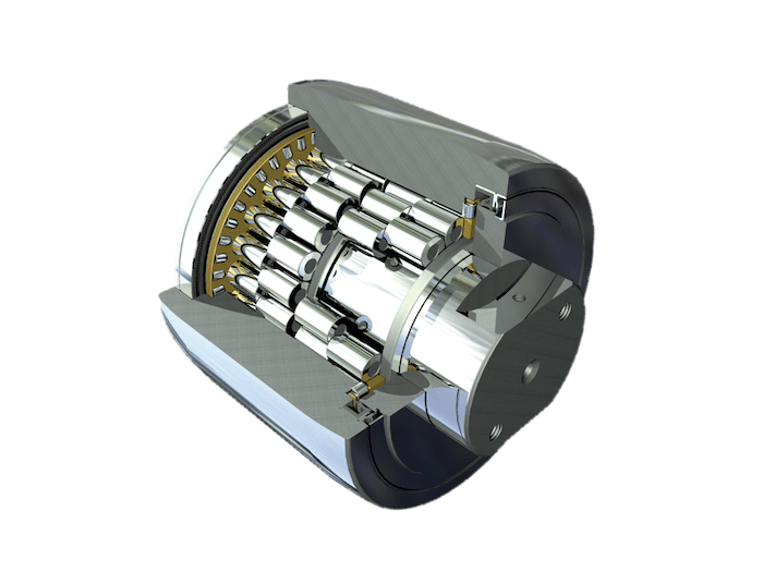

           Backup rollers with integrated stud for cold rolling
          Backup roller with integrated stud for straightening machine

Backup rollers are indispensable in cold working machines, performing crucial tasks such as straightening, levelling, and flattening steel strips. These rollers endure high radial forces, often coupled with axial forces, necessitating robust design and material integrity. The evolving demands of the steel industry have led to advancements in backup roll technology, with manufacturers now offering application-specific designs that cater to diverse industrial requirements.

Backup rolls come in a variety of internal and external designs, tailored to specific applications. Depending on operational needs, they can be permanently lubricated or require periodic lubrication. Low starting torque is another crucial factor in their design, as it helps minimize friction and enhances efficiency.
Many of these rolls operate in harsh environments, frequently exposed to large quantities of water, oil, and industrial pollutants. Such conditions increase the risk of premature corrosion and wear, necessitating a robust sealing system. At TTS, meticulous attention is given to the selection of lubricants and sealing mechanisms, ensuring enhanced longevity and reliability in demanding applications.
