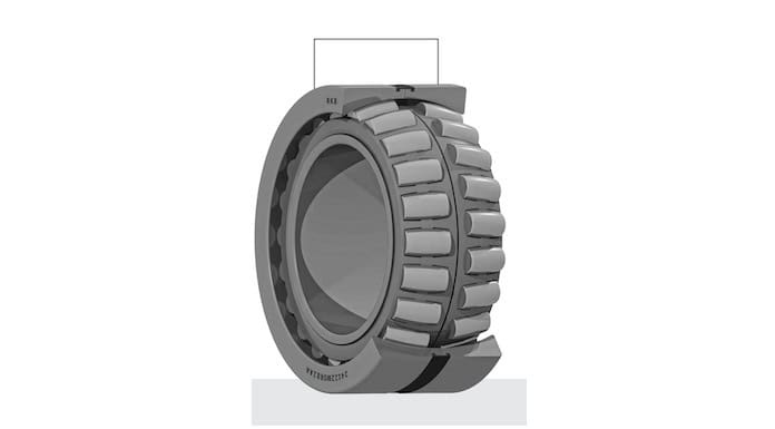

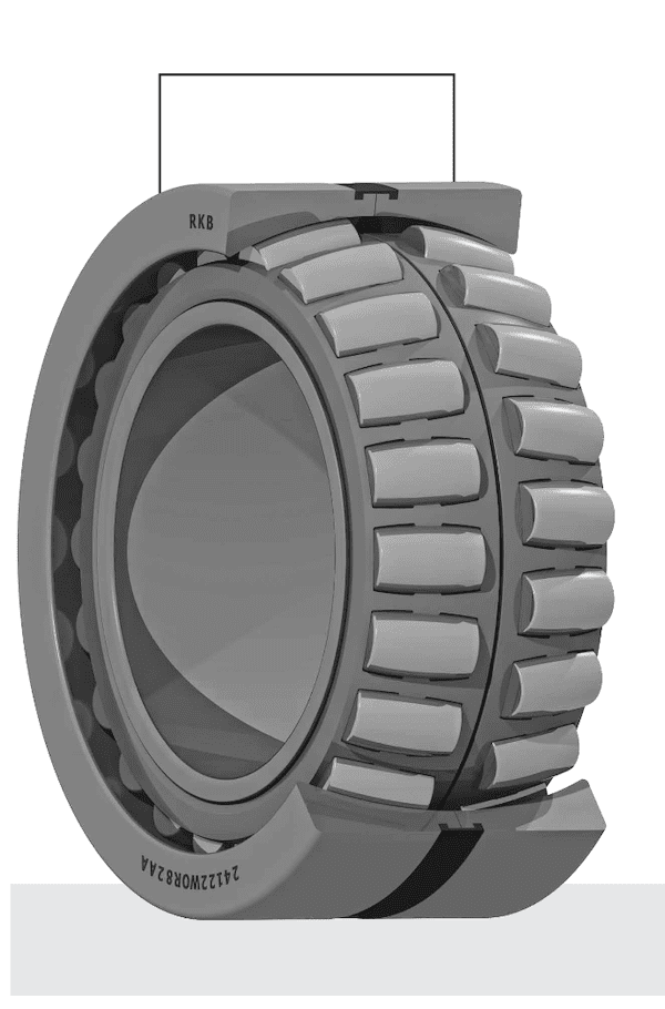

To address these demands, RKB developed a wide outer ring (WOR) spherical roller bearing specifically for concrete mixer drum drives. Three design variants were evaluated during development: the 24122 WOR82A, the 24122 WOR82, and the 24122 WOR82AA. Each incorporated different combinations of internal geometry, contact angles, cage architecture, roller symmetry, and rib design. The objective was to determine which configuration would provide the most favourable balance of misalignment capacity, internal load distribution, rolling contact behaviour, and fatigue-resistant service life.

Among the three investigated designs, the WOR82AA consistently demonstrated the most favourable mechanical response. Its reinforced rib, symmetrical rollers, and increased number of rolling elements delivered lower internal stresses and reduced peak contact pressures. The pressure field across the bearing was more uniform, and roller guidance remained stable even under large misalignment angles. The combination of these features resulted in higher basic load ratings and improved fatigue life compared with the alternative designs.
Based on the combined results of the operating-life analysis, FEM simulations, and semi-analytical studies, the 24122 WOR82AA stands out as RKB’s most robust and efficient bearing solution for concrete mixer drum drives. Its ability to manage large misalignments, maintain low stress levels within the inner ring and rib, and operate reliably under low-speed lubrication and shock-loaded conditions makes it a highly durable option. The bearing’s improved internal geometry and optimised load distribution ultimately translate into increased reliability and significantly extended service life for the gearbox assembly.
