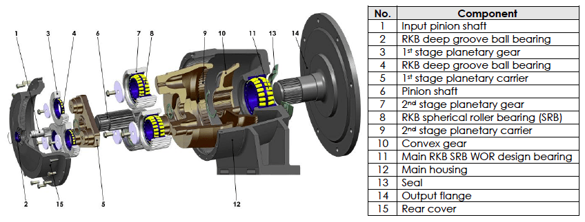

The exploded arrangement in Fig. 1 highlights the main components of the double stage planetary gear speed reducer through which a hydraulic motor drives the mixing drum.
The hydraulic motor transfers the rotational movement to the input pinion shaft 1, that drives the 1st stage planetary gear 3, with deep groove ball bearings 4 that rotate the pinion shaft 6 of the 2nd stage planetary gear 7 sustained by SRB 8 inside it. The 2nd stage planetary carrier 9 couples the crown gear 10 that transmits the torque forces to the output flange 14, also absorbing misalignment. The main SRB WOR design 11 is protected against contaminated environment by the seal 13. The gearbox has to be mounted on a rigid, free distortion support. If the mounting is not rigid, it can damage the internal gears, the seals, and finally the bearings.
The configuration of this design is engineered to withstand the application requisite operating conditions in a safe and reliable way. This objective is attained with described gearboxes, which drive and pivotally support the mixing drum, compensating the motion between the mixing drum and the main bearing case.

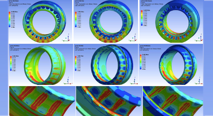

The general behavior of the bearings in terms of von Mises normalized equivalent stress distributions (Fig. 14) has been evaluated without taking into account the values in the shallow layers of contact areas. To correctly assess the contact pressures distribution it is necessary to assign a huge amount of finite elements to each contact zone leading to unacceptable computational time. To reduce the computational time, the NON-HERTZ software has been used to solve the contact pressures between the rollers and inner ring raceway.
Considering the reaction force distributions depicted in Fig. 13 a, b and the internal geometrical peculiarities, the bearing subjected to the highest stress is the 24122 WOR82 design, due to the fact that its Rx force magnitude contributes to increase the stresses inside the inner ring. By using these results as a reference, a normalization method has been applied for the three designs.
The same concept followed in case of bearing assemblies has been used also to evaluate von Mises normalized equivalent stress distributions inside the inner rings (Fig. 15). Analyzing the von Mises stress graphics related to the inner ring, it can be observed that the central fixed rib is subjected to load. 24122 WOR82AA design presents a reduced stress magnitude than 24122 WOR82. These results are confirmed by the graphic from Fig. 13 b, where the reaction forces Rx of the 24122 WOR82AA are significantly lower than those of 24122 WOR82.
Moreover analyzing in detail the inner ring stress distributions from Fig. 17 a, the presence of edge stress concentrations on the proximity of the inner raceway edge of 24122 WOR82A design can be observed. A possible explanation of this effect is connected to the rotation of the rollers around an axis perpendicular to the main axis of the bearing, induced by the high misalignment of the mixing drum and the heavy axial load, that tend to modify the contact area between rollers and raceways. This effect is reduced in the other two designs (Fig. 17 b, c) by the central fixed rib, which guides the rollers during bearing operation. Still, high forces act on the central fixed rib of 24122 WOR82 design (Fig. 17 b), which induces, as mentioned before, undesirable stresses inside the rib. As for 24122 WOR82AA design, very low edge stresses on the inner ring raceway and a proper guidance of the rollers are ensured without causing undesired stresses inside the central fixed rib.

Fig. 20 reveals significant differences in terms of von Mises equivalent stress magnitude through the whole inner ring thickness between 24122 WOR82AA and the other two designs. It is evident that the geometrical characteristics and contact pressures distribution of 24122 WOR82AA design result in a lower equivalent stress, thus leading to a better overall performance of the bearing.
