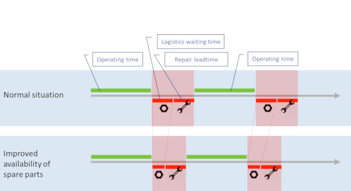

The direct relationship between the timely availability of spare parts and system availability (in this example the deployability of aircraft) becomes clear from the simple numerical examples below. A technical system is “Up” (it works, green in the picture below) or “Down” (it does not work, red in the picture below). During the time that a system is down, maintenance is carried out or the system waits for it. That waiting time is caused by not having one of the following immediately available: People, Resources, Methods or Materials[1].
In the normal situation in the picture below, half of the ‘Down’ time (28% per year) consists of waiting for materials (14%) and the other half of actual maintenance (14%).
